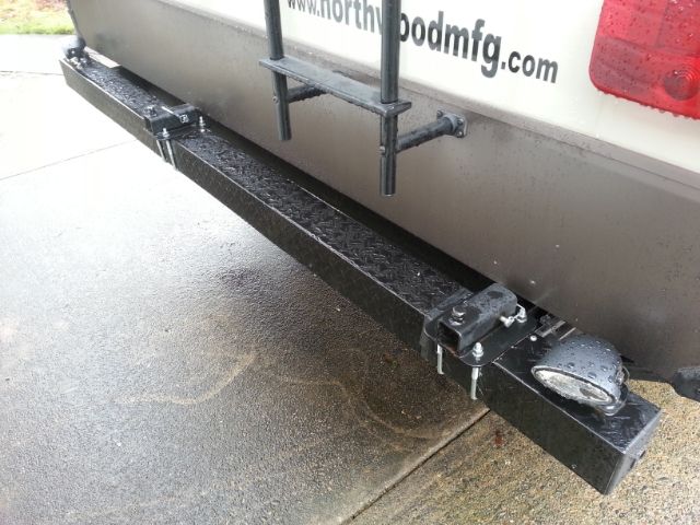

Added some backup lights a few weeks ago. We went camping about 3 weeks ago and arrived at night. Had trouble seeing what was happening with the wife waving a flashlight around:). I had these laying around from my MC days and never added them to the MC.
So I put them on the back of our 5'er. They are 55W driving lights. They came with all the mounting brackets and switch. I ran the wiring along the door side of the 5'er and wire tied it to the frame. Then ran a fused wire from a battery to the switch. I them installed the rocker switch in the propane compartment since that is the only door that doesn't have a key lock on it. Plus the wife can get out on her side and flip the switch easier.
I didn't want to use the trucks backup wiring in the 7-pin plug cause I wanted them on when driving forward. I angled them down and to the outside a little.
We went camping this last weekend and once again arrived in the dark. Flipped the lights on and bingo. They lite up about 4' to the side and about 8' behind. I had no trouble seeing where to back in.
In case anyone is wondering what those square tubes clamped on to the bumper are, they're for a bike rack.

    I did something similar, but with two little cheapie LED (white) fog lights and mounted them on little round magnets. I made up a pigtail that plugs into the trailer wiring socket.
    Being magnetic mount I can place and angle them anywhere I want.

    Only thing I recommend is manual switch's OFF position is down. Thus, any road bumps would flip switch to off. If down is ON and one hits a bump, the rear lights could "accidentally" flip on. If kids around and they like to flip switches (like my kids - LOL!), suggest pulling its 12V fuse. And, only install the 12V fuse before the road trip.

  • I certainly hope you used a relay and didn't wire directly. I see you have a fuse and that's a good call. Explosive proof switches are easy to find.
  • Not trying to find fault, and don't take this the wrong way, but I seriously
    doubt that the rocker switch inside the propane cabinet is "Explosion Proof".
    Be sure to tell the wife to smell for gas leaks BEFORE turning on the switch.
  • Those look like the lights I used but I ran my wire all the way to the junction box where I could hook to the wire in the pigtail. Mine come on whenever the truck goes in reverse.
  • Good idea about the switch in the unlocked compartment but we have tongue mounted tanks. The water heater door can be padlocked but I have never seen one locked.
    We keep our spare keys hidden in ours .

    Bike rack won't go anywhere. It's a Northwood built frame not a Lippert and the bumper is solidly welded to the frame. There used to be a spare tire mounted on the bumper. I really doubt that two 20lb bikes are any worse. After close to 5000 towing miles last year over some bumpy roads, everything's holding up perfectly.
