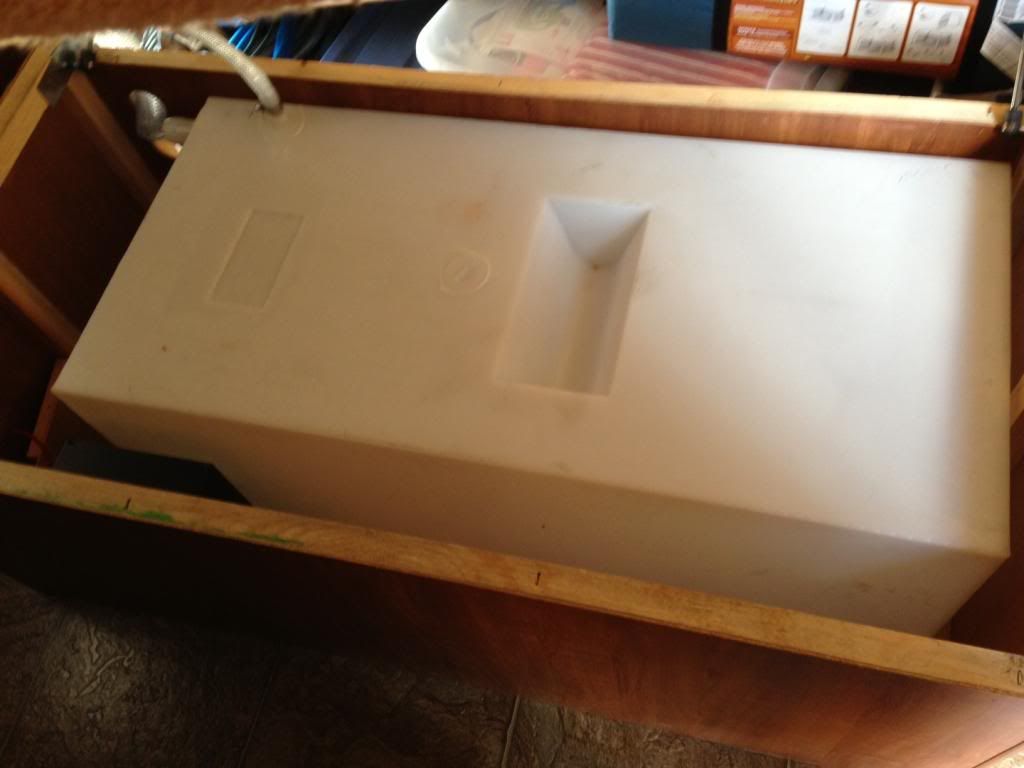

    -New Water Tank installed under bed, from D&M Plastics from Lacombe AB, RFW 1040 model and it holds 168 liters or 44 gallons

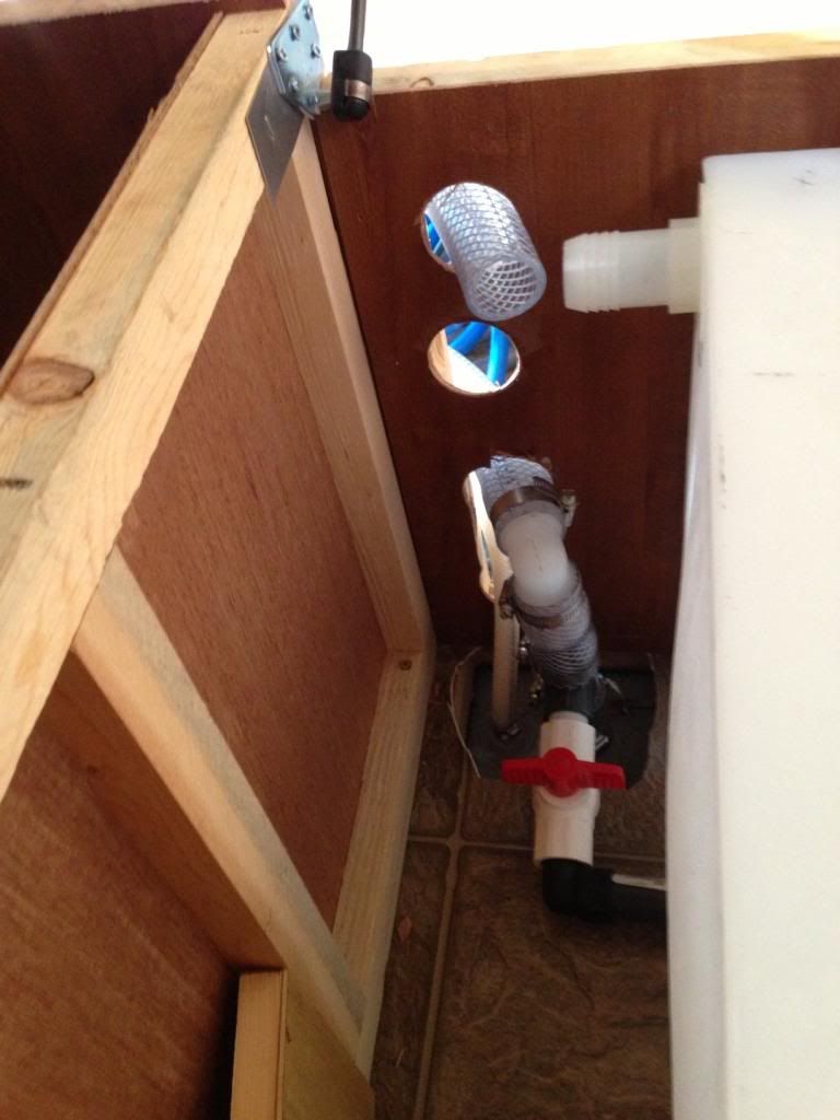

    -high level shot showing angles and plumbing

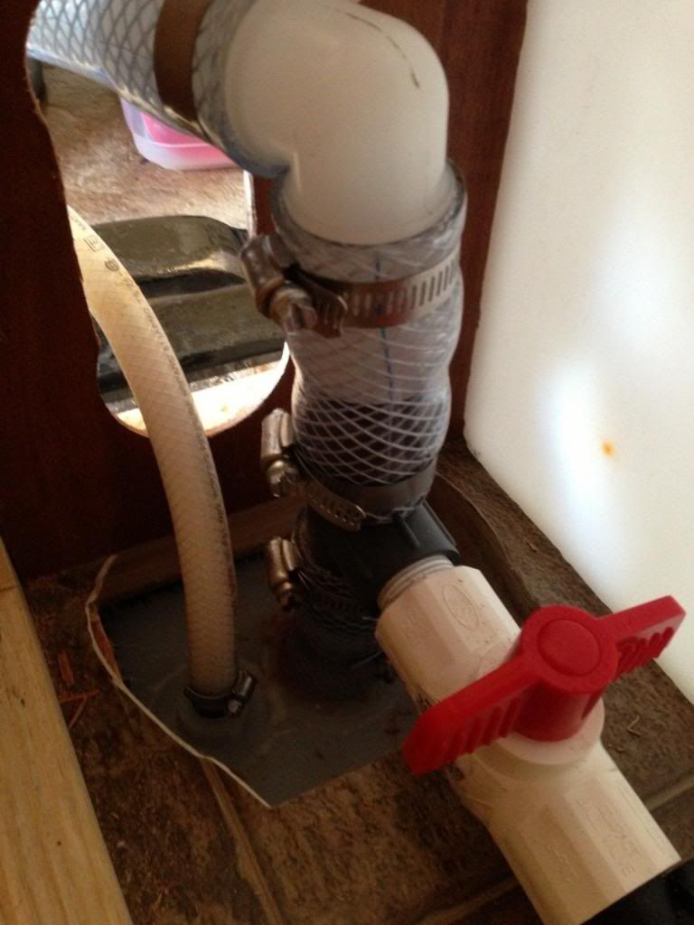

    -Close up of gate valve and 3/4 tank and tee fitting. the tee is 1-1/4" barbed by 1-1/4" barbed by 3/4" threaded. The gate valve is 3/4" threaded and I used some irrigation fittings.

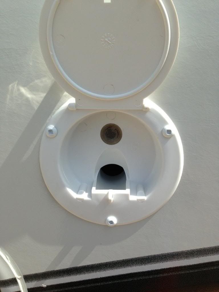

    -New water fill mounted above factory
    -New water fill from American RV, this one is lockable and includes a 1/2" vent line as well as 1-1/4" fill line

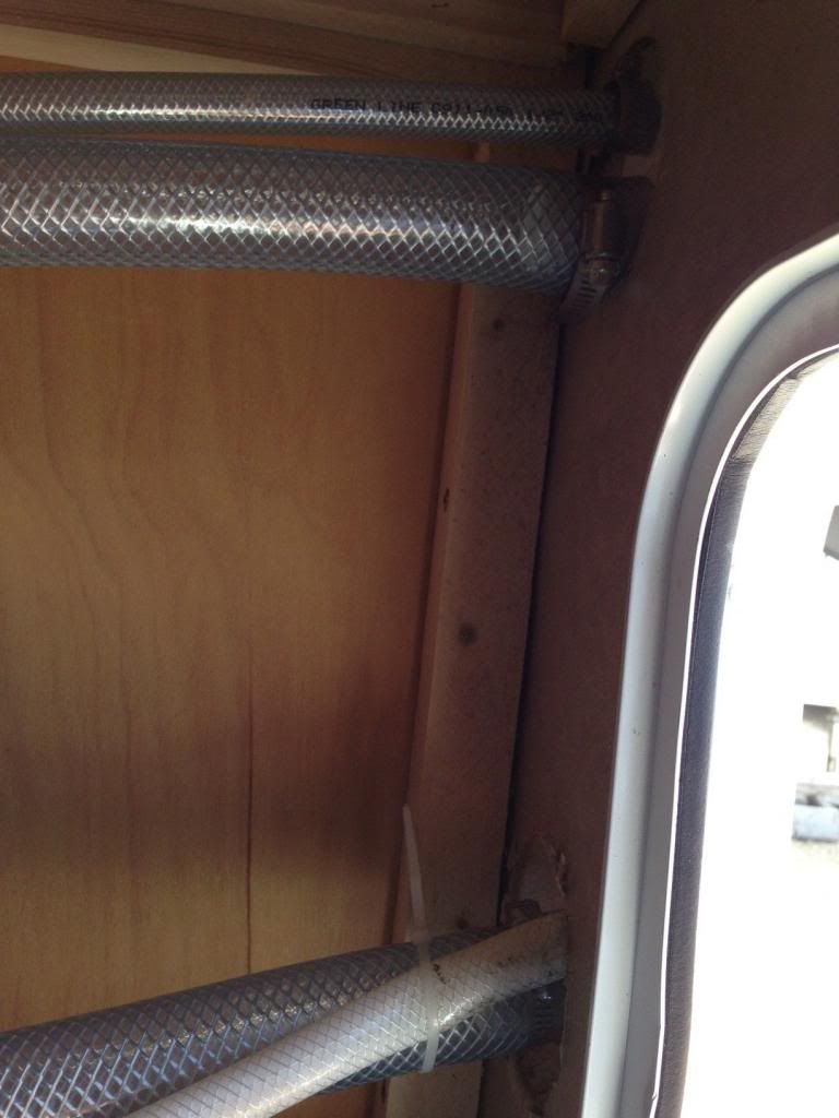

    -Shows new lines from inside the passthrough to the under bed storage.
