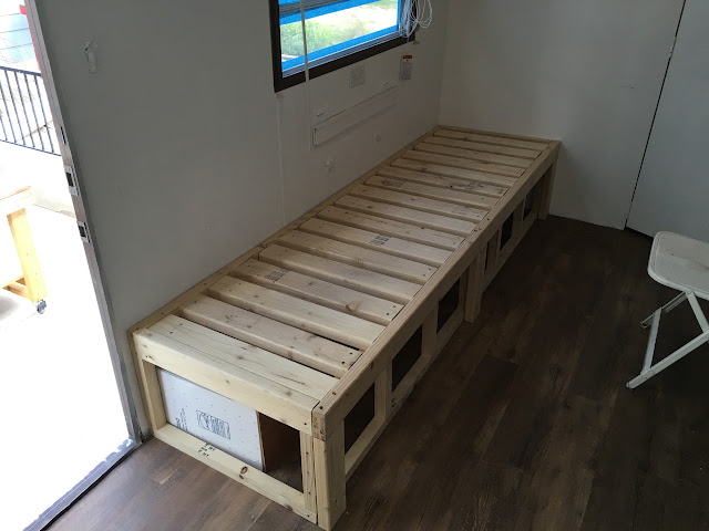

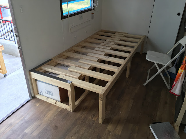

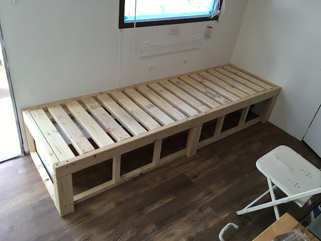

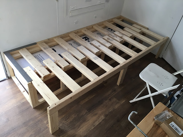

This is where I am at. Building a custom sliding couch bed where the dinette used to be. If you want to know more about any of these projects please visit the blog which has more/larger pictures. Thanks!

  • Continued progress on the side out couch/bed:
    It's starting to look like a bench. I got it screwed in and installed a board underneath to limit how far it can be pulled out. This really is a "1000 pound kid bed". I can stand on any point and there is no hint as to the limit it can hold. Maybe I built it too well.
