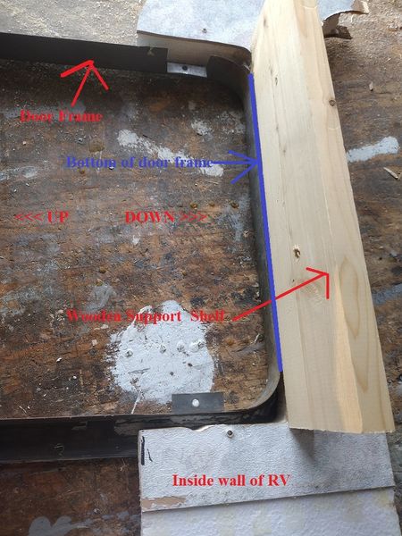

Help with changing the location of my 6 gallon Suburban hot water heater
I'm  in my RV. I have already removed the support structure from the old location. And what I forgot to take note of is where is the plywood that supports the hot water heater is located in reference (vertically) to the water heater door frame. I attached a photo to help explain this question. The location (height) of the plywood support must be at the right location (vertically) so that the Heater matches up exactly to the frame door. Know what I mean? If you look at the blue line in the image, that's the edge (lip) of the door frame at the bottom of the frame. Does the plywood support shelf (pine board in the image) line up exactly to the bottom lip of the frame, as I have it in the pic?
Any help is much appreciated!!!
2 Replies
  • I will give you the secret. Don't share it or everyone will know.
    look at the installation instructions and requirements. That will tell you everything the original installers knew. Now you will be able to finish your project.
    • Grit_dog's avatar
      Grit_dog
      Navigator III
      I get where you’re going with this, but this really seems like something that ya just gotta lay out yourself to make it work.
