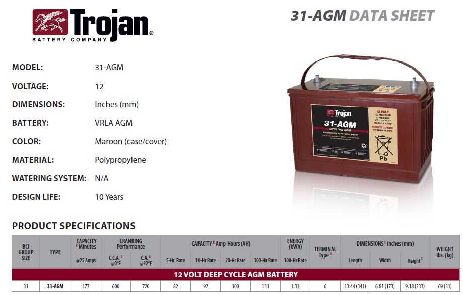

    I hate it when you pick batteries that has minimal specs included with them.
    The SCHMACHER 12VDC AGM spec sheet says it is a 110AH and weighs 68LBS.. That is about all the info you get.
    You can compare that to a TROJAN 31-AGM which weighs around 69LBS... TROJAN lists all their specs for all to see... Then you can get a better idea what to expect performance wise... i.e This battery will produce 12VDC@25AMPS for 177 minutes (2.95 hours). Six of these in parallel will produce 12VDC 12VDC@25AMPS for 17.7 hours... That might keep you going until the HIGH SUN comes out again to re-charge them again. Also re-charging any deep cycle battery that has been depleted down to the 50% charge state will want to see around 14.4VDC @ 17-20AMPS of DC Charge per battery in the bank if you want them to get re-charged in a short three hour time frame. In your case the initial DC charge demand for the six batteries in parallel will be in the neighborhood of 120AMPS DC Current. With a typical 120WATT solar panel only producing around 6AMPS DC CURRENT when in HIGH SUN you are a very long way from getting there if you want the batteries to get re-charged to at least 90% charge state in a three hour window.
    Also you see CRANKING AMPS so this tells you it is not a TRUE DEEP CYCLE battery.
    Being on SOLAR I imagine you will running down the batteries to their 50% charge states many times more than just keeping them topped off all the time. I would definitely want DEEP CYCLE BATTERIES in the mix which are designed to do many of these up and down charge cycles...
    Just things to think about and plan for...
    Roy Ken
