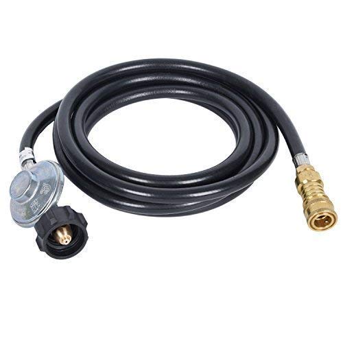

    allen8106 wrote:
    Bobbo wrote:
    Propane hose with regulator and quick connect
    The Weber Q requires a non-regulated supply.
    The Q DOES require a regulated supply, but you only need one regulator in the line, not 2, so that's why folks remove the regulator from the Q when running off the RV's quick connect, which is a line regulated by the RV's propane regulator near the tanks, so the Q is receiving regulated propane.
    The OP's problem was he removed the Q's regulator for RV use but now wants to sell the Q and no longer had the regulator to re-install to put it back to original.

    I recommend you screw the regulator back on. Righty-Tighty.
    Or buy a regulator. The option Bobbo posted will work fine too.
    The newer Q's have a mounting bracket that comes with the regulator and it looks like they go from $42 to $64 on Amazon depending on which one you need.
    Or, you could sell it as an "already converted Q" with a quick connect hose set up for RV use only. I believe cheaper aftermarket regulators are available too.
    On the other hand, if you kept the old regulator, it won't cost you anything; just remove the quick connect nipple from the Q and put your regulator back on.
