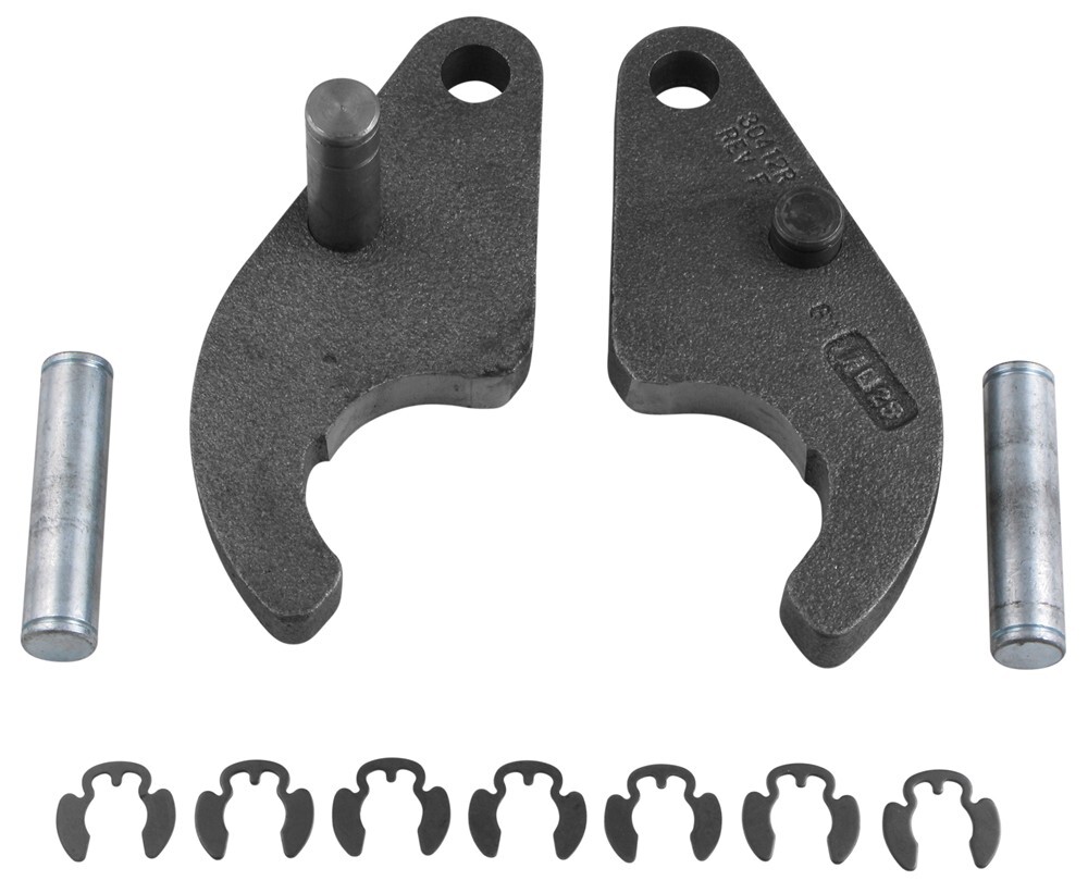

I RECENTED BOUGHT A USED 5TH WHEEL 32FT RV AND A USED REESE 16K HITCH. I AM A CDL DRIVER WITH MANY YRS EXP. PULLING MANY TRACTOR TRAILERS AND MANY OTHER TYPES OF TRAILERS. I HOOKED UP THE TRAILER PROPERLY AND CHECKED MY HOOKUP,ALL LOOKED GOOD.I DROVE ABOUT 2 MILES AND THE TRAILER BROKE LOOSE FROM TRUCK AND LANDED ON THE STREET.AFTER DEALING WITH GETTING THE TRUCK AND TRAILER HOME I TOOK A CLOSE LOOK AT HITCH AND FOUND THAT A PIN THAT IS FASTENED TO ONE OF THE JAWS TO HOLD THEM IN THE CLOSED POSITION BY WAYS OF PINS AND LINKAGE, BROKE LOOSE FROM THE JAW AND FELL DOWN FROM THE HOLE IN THE JAW IT WAS WELDED TOO WITH A PLUG WELD ON THE TOP SIDE OF THE JAW, FELL DOWN AND ALLOWED THE JAW OPEN AND RELEASE THE TRAILER.DID ANYONE EVER HEAR OF THIS HAPPENING? I WOULD BE INTERESTED IN HEARING ANY COMMENTS THANKS.
