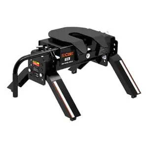

Hello,
I have been doing some studying over the last few weeks on fifth wheel hitches. Seems like about 10 years ago or so there were a lot of fans of the RBW Lil' Rocker.
This is a slide bar hitch but it has an additional tension bar to take the slack out of the hitch from the king pin and the slide bar. This is a common complaint about the Reese Pro Series 15k fifth wheel hitch... slack and rattle. Seems that the RBW Lil' Rocker didn't have near the chucking issue from this slack.
Anyhow, RBW was bought out AL-KO and basically the hitches stopped being built.
I really like the Curt E16 hitch and after some studying it appears to be a near twin to the RBW Lil' Rocker!
Here is a pic of the E16
And here is a pic of the Lil' Rocker
Intrigued I decided to try to find the instruction manuals.... sure enough much of the Curt E16 was copy and pasted from the Lil' Rockers instructions.
Lil' Rocker Instructions - Go to page 20
Curt E16 Instructions - go to page 4
The locking mechanism is the same, the rear tension bar is the same. The hitch head is basically the same. The base legs looks different which is probably why there is a 15k rating on the Lil' Rocker and a 16k on the Curt.
Not sure how or when Curt got the Rights to the Lil' Rocker but if there are fans of this old hitch looking for a replacement.. looks like the Curt is the answer.
Thanks!
Jeremiah
