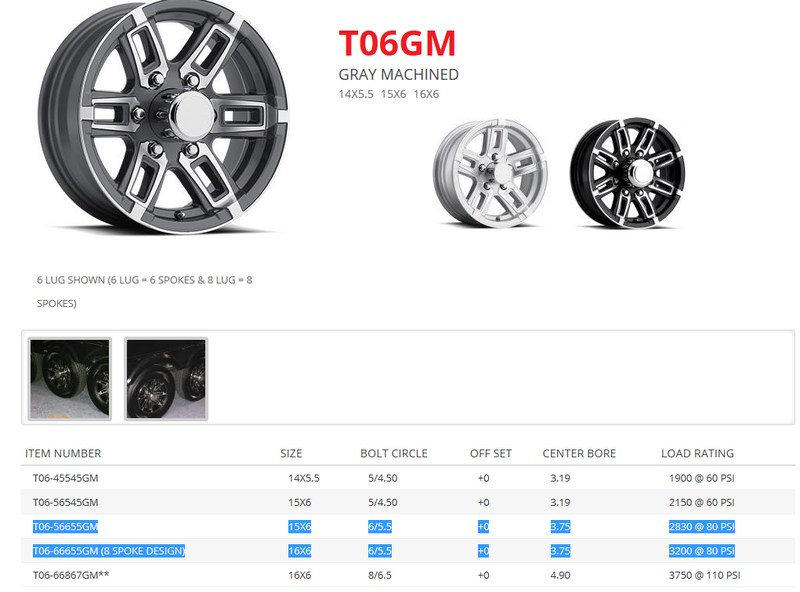

Wheels I'm ordering next week:
I had 4.3" between before, i'll now have 2.3" spacing which as I understand is acceptable. I've also got plenty of clearance above - the 5er is now 1" higher between the flood and axles so the extra inch of tire height will not be an issue. I've spent the last 3 months pouring over every detail and measurement to make sure everything will work and I'm 100% confident with this setup.
those wheels are rates @ 3200lbs/80PSI VS the stock 15's that are rated at 2830lbs/80PSI.
For what its worth, all 16x6 wheels with the 6x5.5 bolt patern seem to hold the same 3200lbs/80PSI ratings.
My unit currently has the Sendal T06GM 15x6 wheels.
http://www.sendelwheel.com/wheels/t06gm
