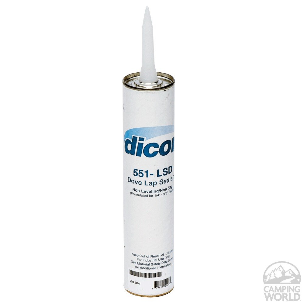

  • The non-leveling Dicor is intended for use on vertical surfaces. The self-leveling Dicor is used on horizontal surfaces such as around the cutouts and cap joints of the roof.

  • I think I will caulk top and sides for extra protection. In the past I have used ProFlex or Silkaflex. Didn't know Dicor had a vertical caulking. I like Proflex but it is extremely hard to get off when you want to recaulk. Any opinions regarding brand of caulking?
  • Some manufacturers caulk some do not. Caulk is an EXTRA protection and is not meant to be the primary weather seal. Be sure to use the VERTICLE Dicor NOT the Dicor you use on the roof. And NEVER use silicone
  • All openings will have either foam or butyl putty tape gasketing. There is no reason you cannot seal three sides with Dicor.
