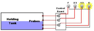

We have an 09 Bighorn 3370, when I press the test button to see how much fresh water is in the tank it will no longer read 1/3, 1/2 or full, the only light that comes on is the empty light with the tank full or empty. Any way to fix this? Thanks

  • Pull level monitor panel and check for loose wires
    If you have access to water tank....check the 4 sensors wiring.
    Otherwise.......when water pump goes 'burrrrrrp' time to add more water to fresh water tank.
  • The only fix I have heard of that actually works it to tear the belly out of the beast and install new sensor systems on the tanks. Not a project for the faint of heart.
