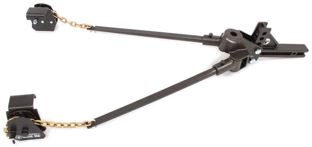

Here are the 2 WD sway control hitches I've been looking at.
What ya think guys ? Which one is best all things considered..?
Blue Ox BXW 2000
20,000 gvw 2000tw
includes 2.5" shank
$599, free shipping
Reese RP66075
17,000 gvw 1700tw
$754 + $140 for 2.5" shank, free shipping

    Bedlam, I looked at that hitch. It is the heaviest duty TT hitch I've ever seen at 30,000gvw/3000tw. And while it probably fits my TW better than the 2000/20,000 Blue Ox, the dual 2" receivers required is a little much for me.
    Looks like a Blue Ox BXW 2000 is in my near future...
    The one thing that worries me, it seems the head unit is the same for all size Blue Ox hitches. Is it really that heavy duty to be able to handle 3500-20,000lb gvw...? And the BXW 2000 comes with a 2.5" shank,,, so does it taper down to a 2" head...?
    Does the head unit really weight 68#..?
  • I have the Sway Pro now. I had the Dual Cam previously
    -The Sway Pro rides a lot better. It's bars are more "springy" so less shock is transmitted from the trailer to the tow rig
    -Sway pro has those nifty rotating chain brackets with a built-in safety pin
    -Sway Pro doesn't have any special setup needs like the Dual Cam
    -Sway pro doesn't squeal and grind on turns as long as its greased
    -Dual cam seems a lot more stable in some conditions. I feel strong crosswinds much more with the Sway Pro when passing trucks (if on the downwind side). The Dual Cam always kept the combination locked together in a straight line. I haven't gotten any sway with the Sway Pro, but never have without weight distribution either. I just feel more solid with the Dual Cam
    My Say bro bar-ends (the pivot part) seem to be wearing a little quick. I'm not sure how much slop is acceptable. For a while, it felt like notches were getting worn in, but they turn freely again so those notches must have worn smooth.
    My dual cam did have one hitch-head failure where the trunnion socket broke, dropping a bar. Others have had this happen too, but Cequent was good to me on the warranty coverage.
    If I did it all over, I'd probably stick with the Sway Pro. It's a little cheaper, and I like the smoother ride.
