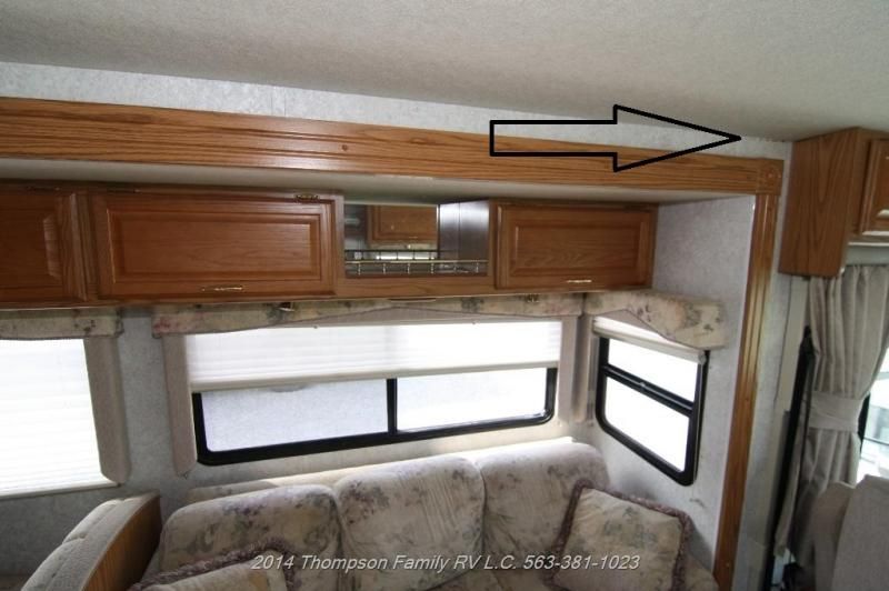

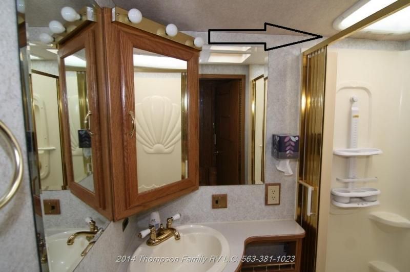

Bruce Brown wrote:
Romer1 wrote:
Thanks all for the responses.
Here's the coach:
32V Adventurer
It looks to be in great shape. I did see a couple of things you might want to take a closer look at. It may very well be just how it looks in the pictures, but up front there was a mark, and around the skylight looked a little suspect. On the '01 in the earlier pictures it also had a leak in the skylight, so it's something to be aware of.
Up front...
Around the skylight...
Good eye. I concur that the skylight has been or is leaking. The question is for how long and id it just drip down the wall into the pan or did it travel down to the floor anywhere.
