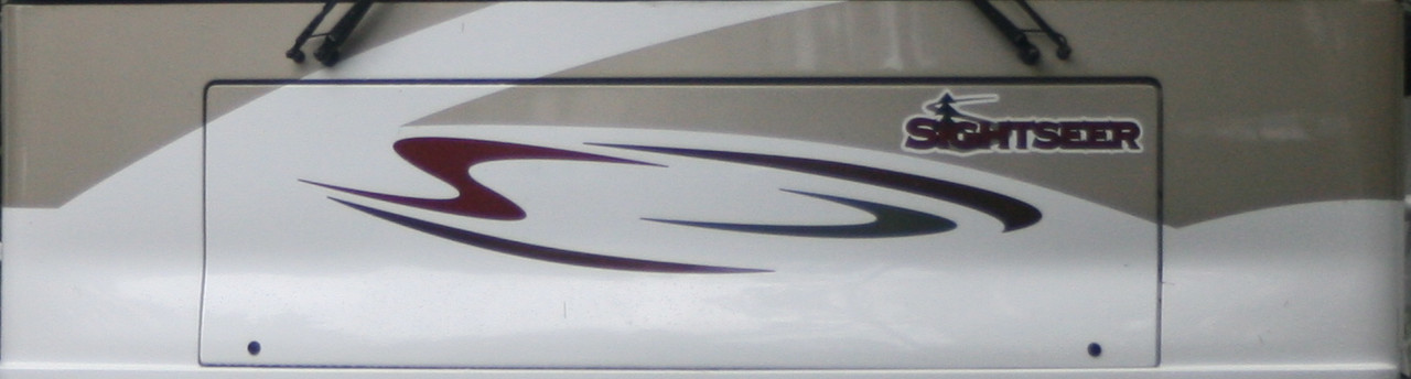

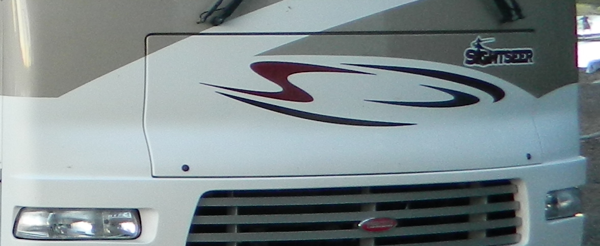

    I have an 07, mine uses the barrel type of key for the hood. I use the key itself to pull the hood open by angling it up or down a bit. If it's like my hood there are a couple of "feet" that help to stop so it's flush with the front of the Coach. But there isn't a lot of adjustment to address the spacing around the edges. Here are a couple links to photos of mine so you can see what mine looks like. The second photo shows the gap at the top better.
    Hoo2 Photo 1
    Hood Photo 2
