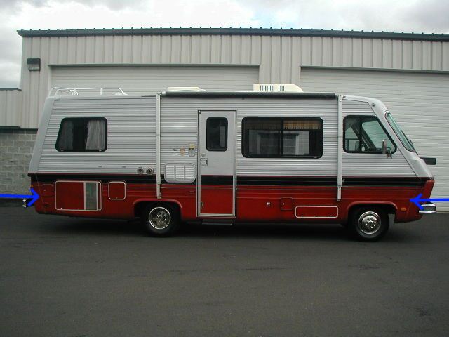

- Here is a pic that I posted a while back about someone who repainted their Pace Arrow.
In this pic I added a pair of blue arrows, one on each end. Those arrows indicate the floor line, and where Fleetwood split the wall siding with the siding below the floor and as a cover for their storage boxes.
I think what I am going to do, is to paint the entire area below that line black. That means the bottom 12" or so will be black and then painted a different color above that.
I've been thinking about a 3 color scheme instead of a single color.

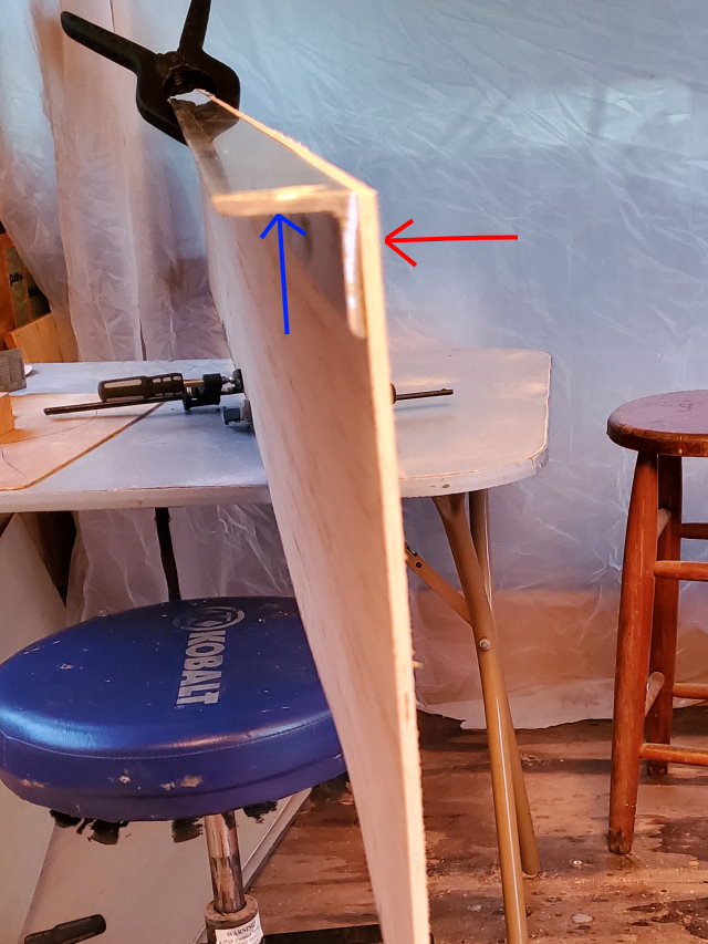

- This shows the end of the panel. There is a piece of aluminum angle at the top on the inside. The Red arrow shows where there will be some screws holding the plywood to the aluminum.
The Blue arrow shows that the screws will go vertical through the aluminum into the bottom of the floor framing. This will allow me to remove these panels at a future date if I so desire.
There will also be additional bracing on the inside to keep this straight as well as adding a bracket to the bottom of the floor to keep the bottom of the plywood from flopping in the wind.
The original siding also had some braces at the bottom to help them remain in place and be sturdy.

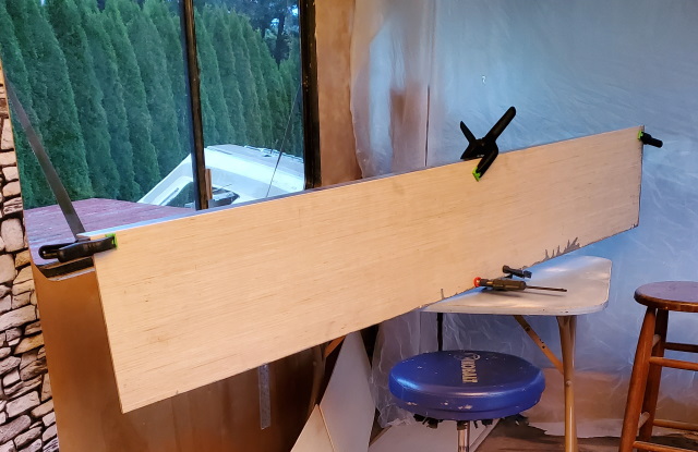

- Here is the start of one of the panels that I am using for the outside, along the sides, under the floor framing.
I had posted a couple of pics last week with the plywood cut roughly to size along the side.

It still looks kind of rough, however, things will start looking better shortly.
I am getting near the point, that much of the work that needs done is more along the line of finish work.
I think that probably well over half of the money has been spent. At this point, I expect to probably be all in for somewhere between 13 and 15K.- Hey! If we're going to have a cream filled doughnut, let's have a Cream Filled Doughnut!
