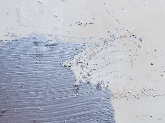

- The second was a coat of silver paint over the Henry's.
This fared a little better. It still scraped off, but not real easily, and it came off in just bits and pieces, like this.
Either way, I would not want to use paint over top of the Tropi-Cool.

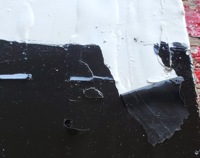

- You may remember a while back that I had applied some Henry's Tropi-Cool silicone roof coating on some plywood.
Got curious the other night, and decided to apply 2 different colors of paint over the coating, just to see if it would stick.
Here's the first. This is black, and after it dried, it just pulled off very easily in a sheet. Not un-expected.
