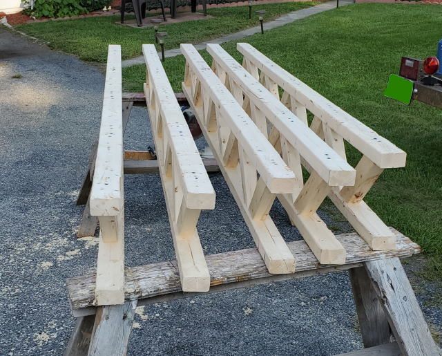

- Step one was to cut all my short pieces for the truss. Then I decided to try using the Kreg jig, instead of running the screws through the top of the 2 x 4, like I did with the 8 foot long, 2 x 3's.

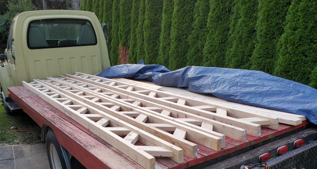

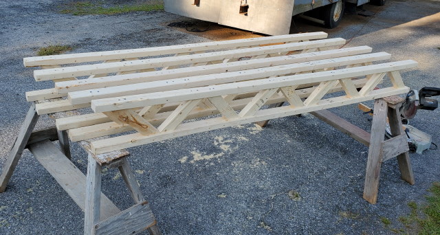

- Here's what I did today. Cut the pieces and assembled 4, yes, 4, trusses, that are 16 feet long. 2 of those on one side, covered with plywood, and the other 2 on the opposite side.
The rest of the sides and the rear will be taken care of by using the 8 foot long trusses.

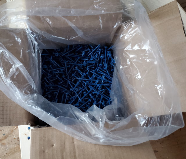

- Amazon was here today! Wahoo!
All 2000 of them. 2-1/2 inch, and coated for use outside. Another situation of much cheaper buying this amount than trying to buy smaller amounts. These were about $80, and for that amount of money, locally, I could get just a touch over 600 screws. - I built another 5 of these today using 2 x 3's that are 8' long. Adding that to the first one I built, and I now have 6 which will yield 3 platforms to walk on.
Now, all I have to do is wait for more screws to arrive tomorrow, since I ran out today.
Building these 5 today, I used 180 screws, and I am not done! The good news is, I can reclaim the screws when I take them apart later. Wahoo! :) Bruce Brown wrote:

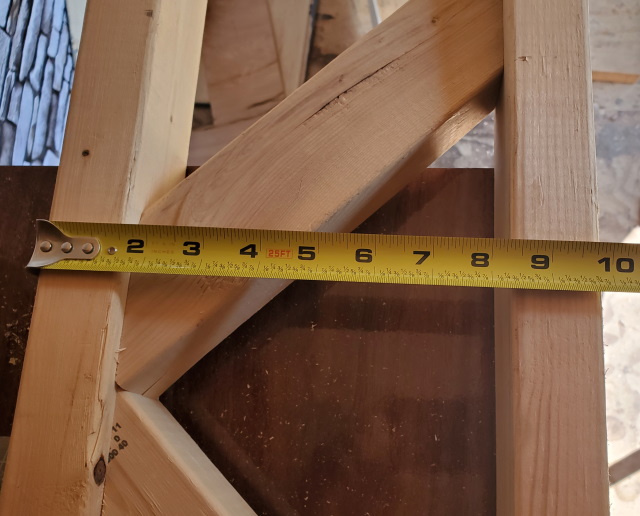

- Here's a look at the height of the truss.
- I think I will make another to match this one, and add some plywood and test the combo, and go from there.

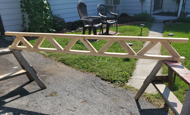

Eventually I decided to "try" making a truss to help support my weight. That is why I was cutting 1 of those 2 x 3's.
This is the result of my first try. Remember, these are 2 x 3's, and not 2 x 4's, and the top and bottom is 8' long.
I did not use any glue, as I wanted to try just using 2.5" Kreg screws to hold it together. Hey, what did I have to lose?
After assembly, I added weight to the top in the center, a little over 300lbs.
Surprisingly, it did not move at all. None. Nice and sturdy. SO, I figured, I can make another one, cover both with plywood, and I should be good to go.
REMEMBER - this is only a temporary truss - it is NOT for long term use, as in a house floor or something like that.
In actuality, this probably won't see weight on it more than a few hours, and then can be dis-assembled, and the wood used for something else.

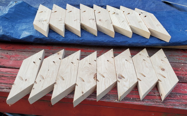

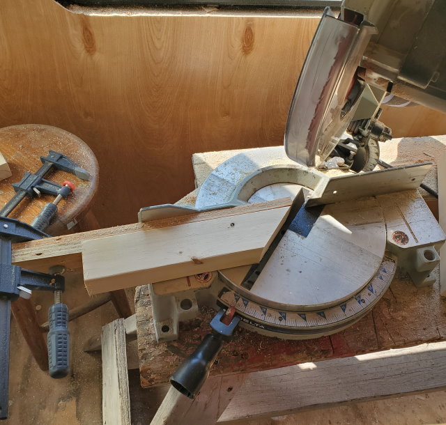

This is not assembled according to industry standards, but after putting weight on it, I am satisfied, it will do what I need it to do, for a short period of time. - I had a few 2" x 3" x 8' pieces of lumber that I had not used yet, so I decided to cut one of them into pieces, and on a 45 degree angle.
Since I was going to do a number of them, I fastened a fence stop on the one end, so all of my cuts would be the same length.
