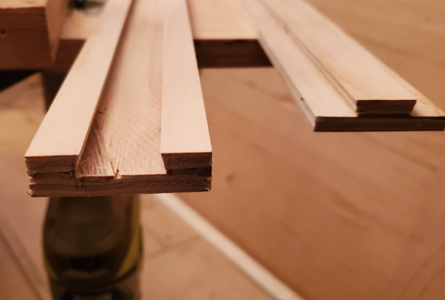

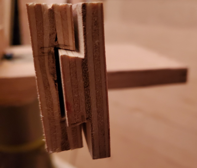

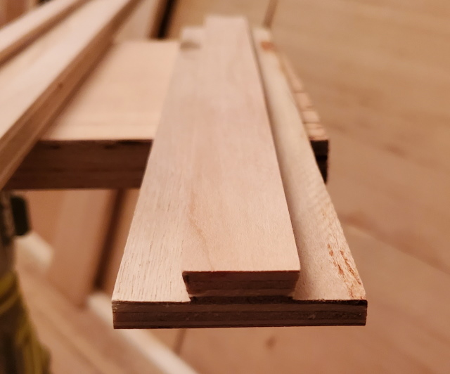

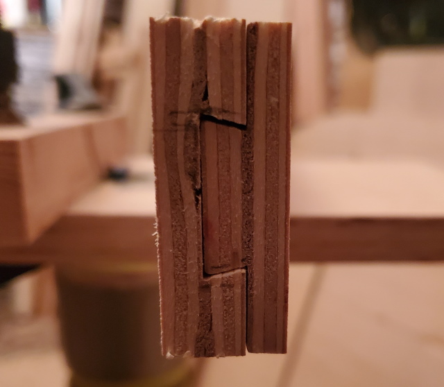

What is that good for?
Well, (IN SOME CIRCUMSTANCES), it makes a nice, drawer slide.
Now I know it sounds like I've lost my mind. What else is new? Lol.
This actually works really well, when done properly.- When we put them together, we end up with something like this.....

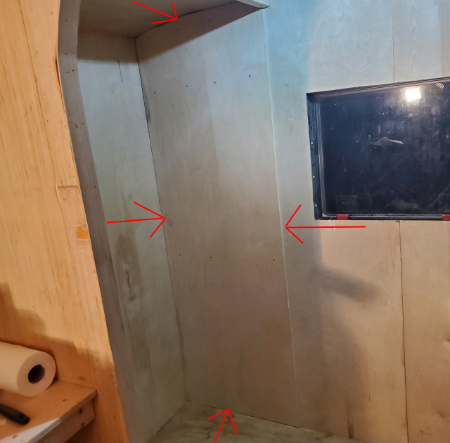

- In addition to that piece, I also needed another wall to use for the other side of the shelving, and to separate the space back there to allow room for the refrigerator.
With that in mind, this piece is a piece of 3/4" plywood. Again, probably overkill, but I wanted something stable and flat there.
This piece is screwed into place with pocket holes and screws, along with Loctite construction adhesive to secure it.
- Finally added a piece of 1/2" thick (sort of), plywood up against the back wall. It is glued and screwed in place.
Purpose of that piece is to have something substantial to screw into, as I want to add some shelves/drawers back there.
