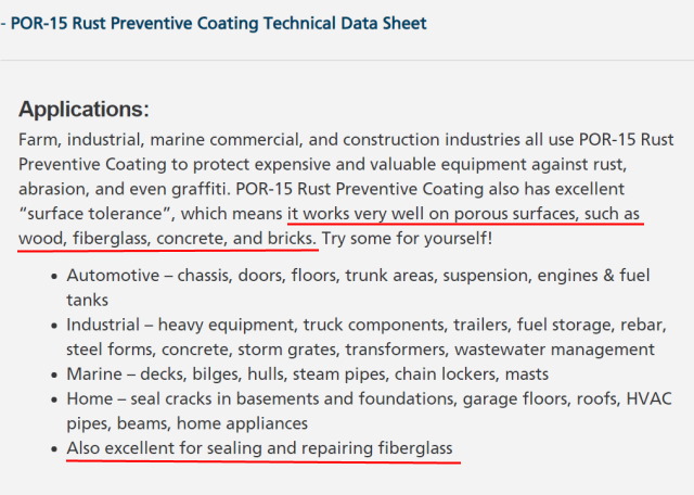

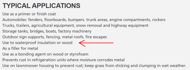

As far as an appropriate coating - Por15's website says it best.
So, since the manufacturer says it is good for wood - I decided to agree with them.
Link for the first picture. Towards the bottom.
Link for the second picture. Click on the "Technical and test data".

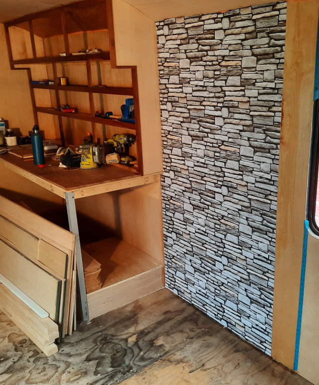

Tonight is one of those nights. This is on the drivers side, obviously just in front of the counter area. This is an area that has been designated for something "different", instead of the old, "blah" cabinets, or something.
Maybe a stove of some sort, or something. Not fully decided yet, but this will be the first thing we see when we enter the coach, since this is directly in front of the entry steps.
Yes, it's wallpaper, so I can change it if I want to.
