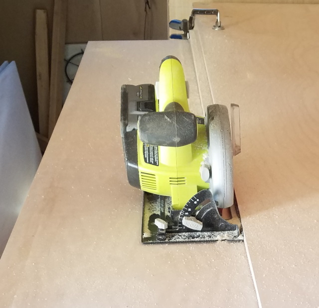

- I broke out the Ryobi circular saw today, and proceeded to start cutting my newly bought plywood to width for the shelving.
If you don't have a long level, you can also use the side of a piece of plywood as a guide for straight cuts on longer pieces. Even though I have the level, I decided to use a piece of plywood for my guide today.
Why? Just because I could!

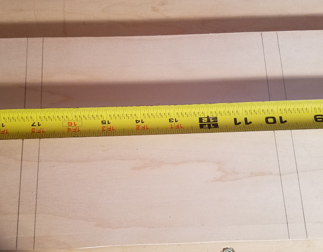

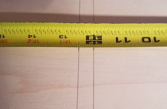

Adding that to the prior total of $9326.53, and we have a new grand total of $9436.37. - First step was to measure up 12 inches from the bottom, then add another 1/2 inch so I knew exactly where the shelf would be.
Then, I cheated. I wanted 7" from the top of the first shelf, to the bottom of the next shelf. In order not to screw up adding or subtracting, I moved the tape measure to the 10" mark, at the top of the first shelf, then moved up 7". That meant 10" low end, 17" high end. 7 inches empty space. Perfect. Then, add another 1/2" for the shelf itself.
After one too many mistakes over the years, it's just easier this way.

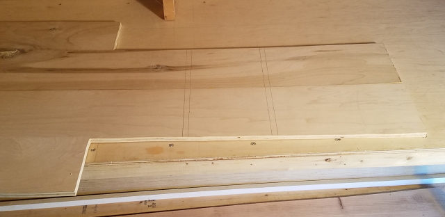

I started laying out the markings on the end panels of the shelves, so I know where the shelves will go.
I measured and marked them, and laid them side by side, just to make sure the shelves will be the same height on both ends.
It's not fun to start putting things together, and suddenly find one end is an inch higher than the other. Been there, done that.

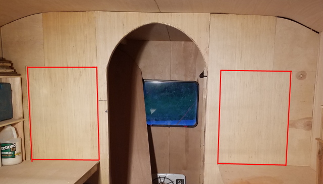

fulltimin wrote:
This is the bath area wall, and the red lines indicate .... (drum roll please)!!!!!! .....
Seriously considering putting a very thin piece of steel there, and probably painting it.
Why? I think it would be a nice place to hang different things with magnets.
I know sometimes people use a magnet to hold their kitchen knives, and so forth.
I was thinking, having a large piece of steel there would allow all kinds of magnetic hooks to be stuck on there.
I like that idea.. our last two Moho's had no metal anywhere for magnets. When I saw this it started me looking for a place to do the same.. not quite as big though.
Since it would not have to be a thick piece, it would not weigh very much. Just need to glue it to the wall to hold it into place.
What do you think? Am I overlooking something here?
