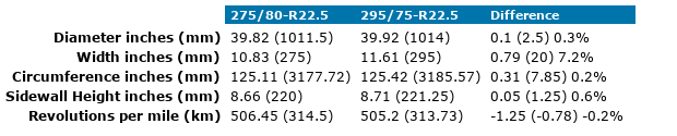

Changing Tire Size
Has anyone switched from a factory tire size of 275/80R22.5 to 295/75R22.5. Tire sizes almost identical only about 3/4" wider. My only concern is the dually spacing of the rear wheels. Thoughts?
The reason is I need a 'H' rated tire and moving to a 295 really opens options.
Thanks
