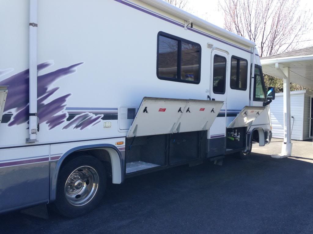

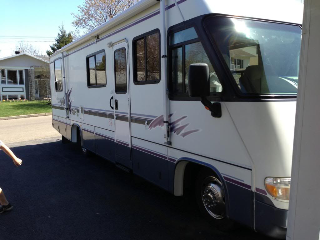

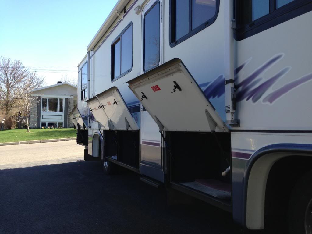

Anyhow I stumbled into 2 that were immaculate, 2 Triple E Commanders 32’. These RV’s are Canadian made and according to what I read are more on the high end side in terms of build quality. They are also 4 seasons built with lots of insulation (even the storage compartments under) and they have heated gray and black tanks.

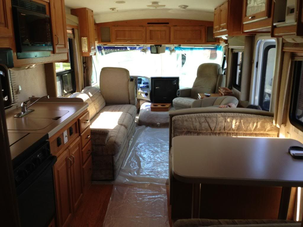

The house portion on the one I purchased is basically like new (the owner had plastics on everywhere) and a solid 163,000km (102,000 miles). Price 14,000$. Knowing mechanical stuff I put aside another 7000 just for the initial repairs (that’s based on owning too many vehicles in my life). It does not have a slide but cabinets are so well built, wood flooring, ceiling that looks like wool, it’s really nice.
The age old question, Chevy or Ford ? Mine is a Chevy P30 1998 with a Vortec 7.4L. The choice of the chassis has nothing to do with the brand, the driver was it was so clean that the chassis is secondary. This being said if comparing 2 rv’s that are equal go for the Ford. Why? Simply because Workhorse parts availability is really bad specifically in Canada and much more expensive. I get mine serviced at a huge truck center which has a Chevrolet dealership also and they service all brands even Ford’s and they are the first to say Ford’s are cheaper to maintain and they never wait for parts. Nuff said….
