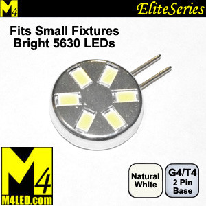

After seeing one of the RVGeeks videos on LED's (they have several to cover all of the different fixtures) I saw that they had the exact same recessed halogen "reading" lights I have, so I ordered what they used for those recessed fixtures, from M4. Expensive, but good quality and fast service, and yes two discounts. Circuit board is protected and potted, not exposed like cheap ones. Those were G4 bi-pin bulbs.
