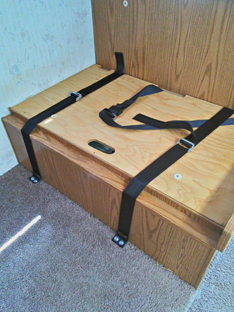

My 20 yo Class C has plywood storage compartments under the dining seats. Since I drive a lot of mountain roads without guardrails, I think about the scenario of rolling down a mountainside. It would not be fun, but having my toolboxes and other heavy gear flying around would not help matters.
After discovering that the 200+ lb water tank was no longer even secured with a single belt and two deck screws, I decided to upgrade to two straps:
Then I went ahead and did the storage compartments also:

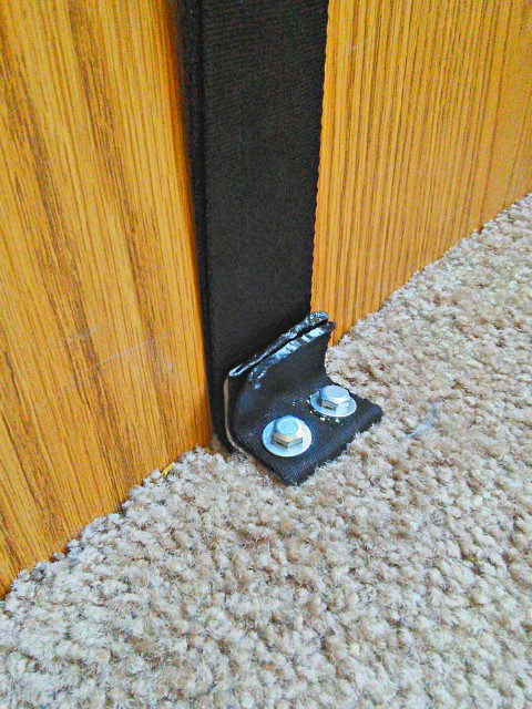

I had two inch mil-spec buckles left over from old harnesses, so I used these. To secure the nylon webbing, I wrapped it around Hillman 1-1/4 inch perforated steel angle from Lowes.
After wrapping, I used a heated nail to melt holes through the webbing. Then I secured each mount with bolts run through the webbing and angle.

In some locations, underneath was accessible so I used 1/4 by 3 inch carriage bolts. The generator blocked one area, so there I used heavy 1/4 by 1-1/2 inch hex lag screws into the plywood flooring:
It might be stronger to sew the webbing, but I believe these mounts are very strong. They are certainly better than nothing, which is what I had before.
As always just tossing this out to give others ideas and your mileage may vary.
