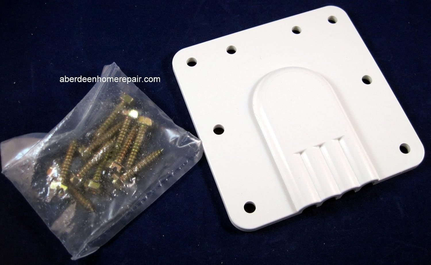

My rooftop sat cables are protected and sealed where they penetrate the roof with a Winwgard cable entry plate with grooves in it for each wire. When I added additional cables for the cell and sat radio antennas, I just ran a bead of Dicor in each groove and a bead where the plate seats on the roof. After screwing the plate down, I sealed the screw heads and the plate edges.
This is the plate I have, but they also have them with different numbers of grooves:
Winegard CE4000 Cable Entry Plate
Thanks, Dutch. That is a great design & should fix my issue. I will have to check into this.
