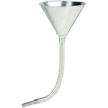

  • I used a funnel like this to fill mine through the dipstick tube. It does take someone to hold the funnel while you add the fluid or you can do it yourself if you are only adding a quart.
