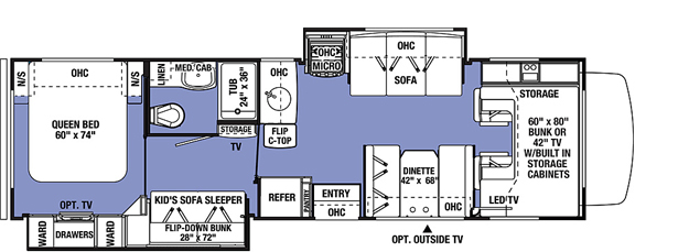

We're leaning towards looking for a Winnebago Access 31J, which came out in 2008:
Similar floorplans from Jayco (Greyhawk 31FS) and Forest River (Sunseeker 3170DS) came out in 2009 and 2010, respectively:
- Anyone with experience with this floorplan?
- Any idea if you can reach the main bedroom / bunks / bath with the slide in? Looks like it is possible but a tight squeeze. Bath access may depend on which way the door opens, it appears to be a little different between the three.

Then we stepped into the FR Sunseeker 3170DS and that point became very clear to us - I had no idea this BH plan existed or had been around for a number of years. Shows how ignorant I've been of the MH market! Bunks for the kids means not converting the living area for sleeping, and they have their own space. Cabover bunk gives flexibility for more kids / bringing friends.

  • We have a 2009 Jayco Greyhawk 31FS. The motorhome is completely usable with both slides in. However, with the bedroom slide in, the wardrobe is snug against the bed, so if you are tall, that could be a problem. I'm 5'11" and my feet just barely touch the wardrobe. The bathroom door also does not fully open, but I'm a big guy and can just squeeze into the bathroom with the slide in.
    When we first bought our Greyhawk in 2009 our kids were 8 and 6 and they loved the idea of the bunk beds. They used the bunks for about 3 years. Now they both complain they are too small. Actually they are too narrow. Our bunks are 29" wide, so an inch narrower than the Winnebago and 3" narrower than your FVer. I think a standard twin is 38" wide.
    They do not use the bunks anymore. They are used as storage and/or for guests. However, we are thinking of having a custom made twin size mattress that is as wide as a normal twin but short enough to fit in the motorhome's lower bunk four our daughter. We'll just use plywood to support the extra 9" width. The mattress should not impede the bathroom door because there is about 6" or so of empty space between the edge of the bed and the end of the slide and there is plenty of room between the door and the slide when it is open.

  • We went from a 5th wheel to the Forest River 3170DS last year and Love it. We love the flexibility we now have. We have been on a few trips with 8 people so far (kids love bringing friends). We can tow our Jeep if we want to or we can tow a motorcycle trailer. So many options we did not have with the 5th wheel. Good luck in your search.

  • Cant answer directly as we have an ASPECT Cl B+. But yes you can get into the bathroom and I would think you could with the access even by looking at the floor plan. Might not open all the way but enough to enter. With our front slide in and the 'round table it is a close squeeze to get by but is doable.
    Its just the 2 of us so we dont worry about 'others' grand kids if ever can use the dinette. Go back to the dealer and have them close the slides and then check it out its the only way to really answer your questions.
