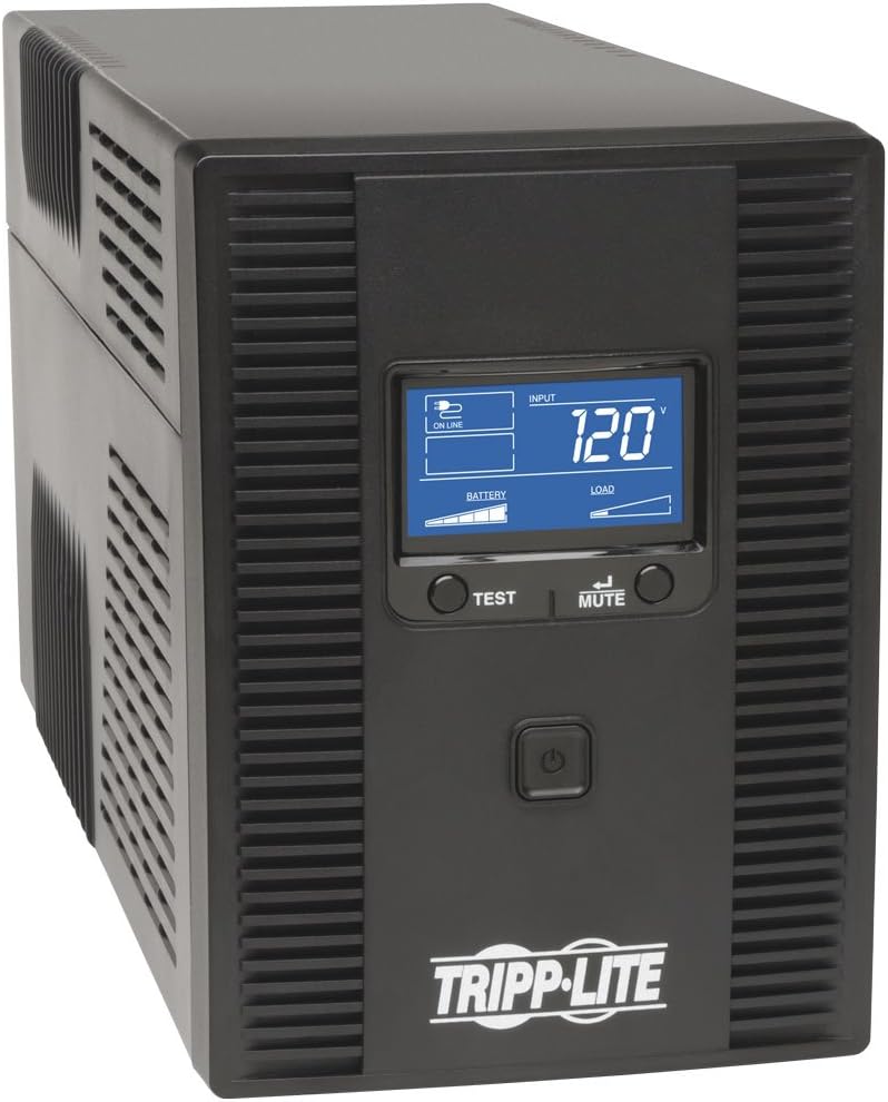

    For power interruptions buy one of these..
    A "UPS" which is a self contained inverter/battery/ATS designed to switch to inverter when power is dropped.
