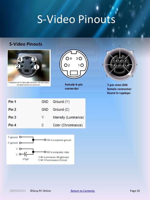

It would neat if I could use the S-VIDEO connector on the PRO1X Docking Station to connect to one of my DELL 2408WFP Monitors and use the PIP Picture in Picture mode to view the M90 Computer when needed. The S-VIDEO MODE is the only PIP/PBP input I can use with my 24-inch monitor. The PRO1X shows this connector to be a TV OUTPUT Mode
On the MONITOR I have a 4-PIN DIN SOCKET and the PRO1X has a 7-PIN DIN socket. I have cannot find a 7-PIN DIN MALE to 4-PIN DIN MALE cable setup to connect between the two units on AMAZON. Did find one from SVIDEO.COM but hate to use my credit card for unknown companies to purchase things. I use AMAZON PRIME all the time with an account. WALMART will probably have a 4-pin din MM cable...
I have read you can plug a 4-PIN DIN connector into the 7-PIN DIN connector and only use 4 of the 7 pins but don't know this for sure. It seems I can order the 4-PIN DIN PLUG Male to Male cable from AMAZON. Wondering if this will work. I don't even know yet the PRO1X will feed my 24-inch MONITOR PIP input and work. I did plug the DELL R17 LAPTOP HDMI cable into a TV SET and it worked just fine selecting HDMI mode on the TV set input controls.

NOTE-I HAVE MY ANSWER NOW TO MY QUESTION: It appears the outside 4-pins of the 7-pin DIN connector is the same dimensions as the 4-pin din connector so I can plug a 4-pin din plug into a 7-pin din connector. The additional three pins on the 7-pin has to do with R-G-B signals.
