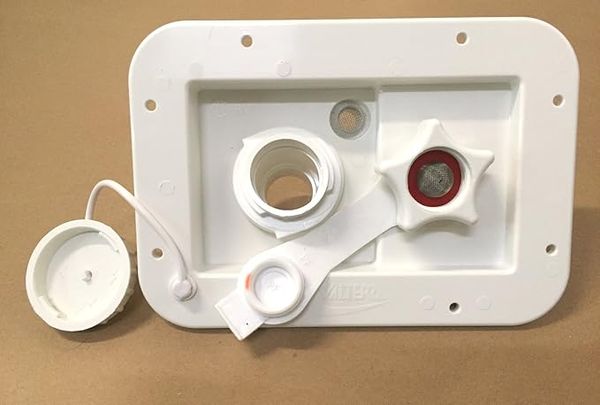

Hello, new to the group and my rv , i bought a 1991 hawkins motorcoach areospace 2 with the 454 , my question is it has to water ports and i am unsure where i attach hose to fill the tank. Thanks

      The left port in the photo above fills the tank. No hose threads and the screened vent prevents pressurizing the tank. The port on the right with the hose threads is for pressurized water. Keep the on-board pump off when hooked up to pressurized water.

  • Virtually none is going to have memorized the particulars of a 35 year old long out of business rv model.
    I would suggest trial and error. Hook up water. Turn it on see where it goes.
    Really only 2 normal options. City water hookup and black tank flusher.

      Or -  city water hookup and gravity fill for FW. Doubt a 35 year old RV had a black tank flush unless it was installed aftermarket.

        ^Fair enough. I presumed “to” (2) hookups meant 2 ports to attach a hose. FW fill cannot be attached to. Although OP didn’t specify.
        if one’s threaded  and one isn’t then there is no question what goes where.
