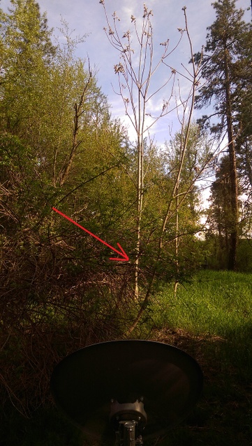

I found a V in the trees for my Slimline HD DTV. The red arrow shows where the Lnb arm is pointing.. at only 34° of elevation. The actual signal comes in from a much higher angle.
I'm getting around 83% signal on the 101 whereas 93-95% is usual sans obstructions. The 99 and 103 sats are strong enough too.

  • Just a little thing to know about aiming a dish antenna that might help you sometime. If you look at the dish mounting, the flat plate on the back of the dish is perpendicular to the line for the satellite. whereas the dish itself seems to be pointed a bit lower. The signal actually bounces off the dish to the LNB at a bit of an angle, but the skew plate on the back actually gives you the true direction. Like the others said, the angle is actually a lot higher than it looks like.

    Cut the tree now, before it gets bigger and more leaves. .
    As soon as the rain stops I'll do that.

  • Cut the tree now, before it gets bigger and more leaves. They are a lot harder to cut when they get bigger also.
  • The signal is coming in 24 degrees higher than the LNB is pointed so you sound like you are mostly in the clear. If the tree breaks out into full leaf you might have a problem.
