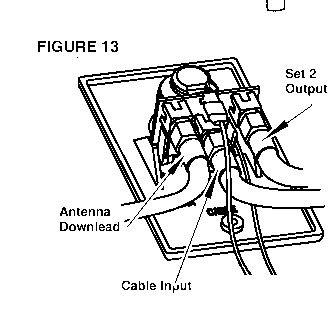

  • This might be of interest. It shows what the coax connections are.
  • Thanks for your quick response. There are three cables screwed to it. One red. One black and one white. When I un-attached the black one the green lite came on steady!? Screw it back together and it goes out?
