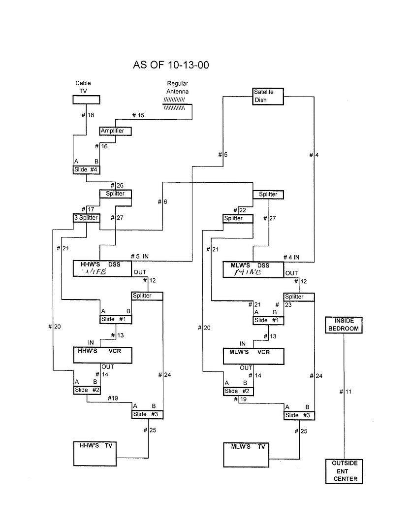

I have color coded the wires from my box with push button.
I know the RED goes to the Batwing antenna.
I know the GREEN and BLUE taped wire goes to the Cable INPUT.
I know the GREEN taped wire goes to the rear Bedroom.
I do know that the GREEN/BLUE wire and the GREEN wire were connected to a Spliter.
The YELLOW taped wire does not go to the Back bedroom or any place else that I find. ANY ideas as to its function?
Here is what I'm trying to accomplish. I am going to add another input for DISH to the Cable and run it to the conglomerate of wires.
Through spliters and A/B switches I will be able to have any of the three inputs (Cable, DISH, Batwing) to either of the TV's.
On the 12 V power supply/ wall plate I connect the Batwing to the left and a pigtail to the right. Front and center will remain empty.
Then I will go about my switching, etc.
Where the yellow goes is my concern and A continuity check shows it is not connected to any of the other wires.
SEE Detail sheet-----hope you can read my scribbling.
