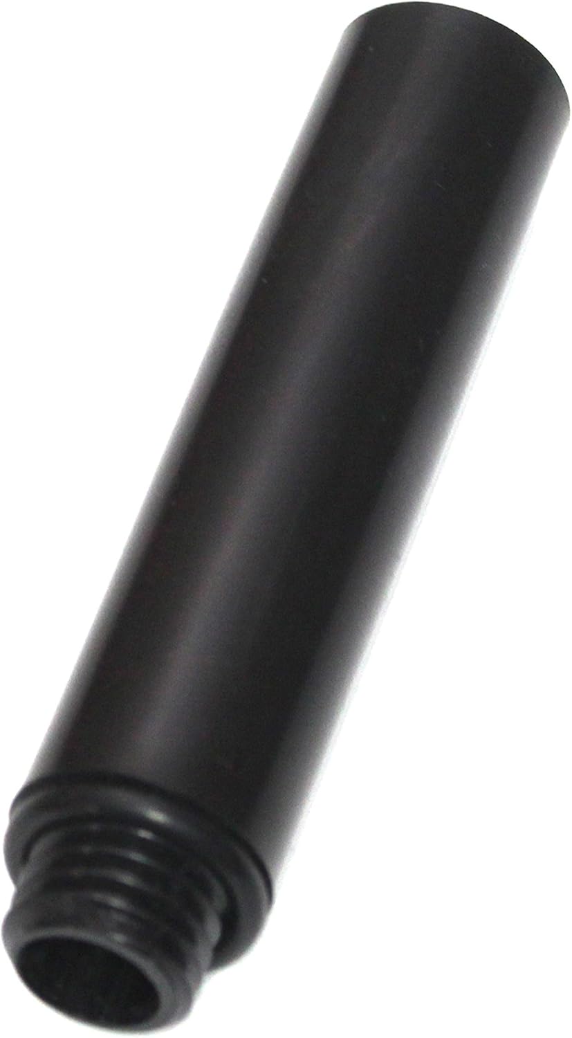

- FLY_4_FUNExplorerI elevate mine on a small stool and insert the aftermarket aluminum funnel (threaded) and then tip it on its side so oil can run out into a drain pan. Once done, add the 400ml oil as recommended and clean up any drips. Should be good to go. Doing it on a scrap of cardboard is also a good precaution.

- cgjtExplorerAlthough I have a 2000w Champion generator, I bought off of eBay a screw in adapter that fits into the oil fill hole and allows a quick no mess drainage of the unit. I am almost positive that they had these listed for other makes including the Honda. If I can find the listing I will forward it. Good luck and stay safe.
