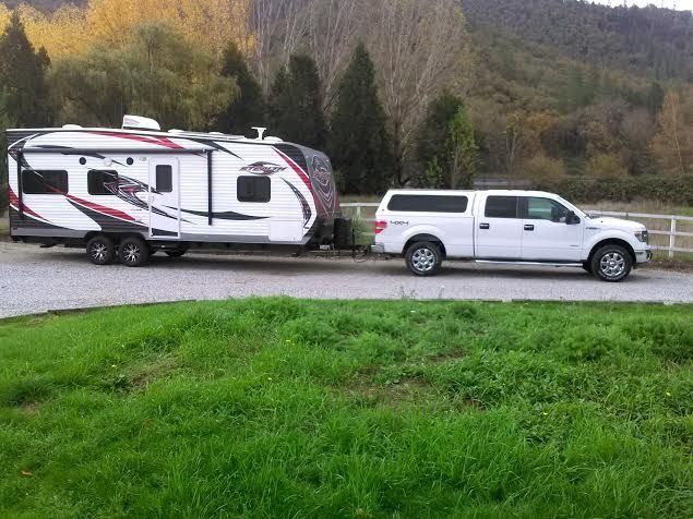

I know we have so many here that know there stuff. I wanted to post what I'm doing and a few photos to see what you all think.
Truck: 2013 F150, Ecoboost Max Tow, 7700GVW, 1800 pounds payload, 11,300 tow rating
Trailer 2015 Surveyor 245BHS, Dry=5300lbs, Payload=2450lbs
Hitch: Eaz-Lift 1000/10000
Here's the photos. Wheel wells measure equal at 37.5 inches. However, stock has the rear 1.5" higher than front. I'm thinking the receiver can go down one notch, and possibly one more link on the WDH?
