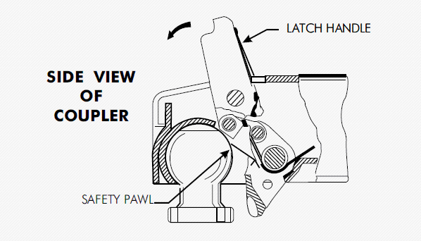

  • What brand is the hitch? Parts are available for some brands.
  • Curious, very curious
    Which part in these diagrams:
    or this one
    Or is yours a different design?
