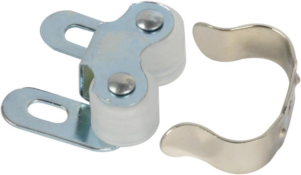

For your cabinet doors, go with some REAL catches, I would highly recommend using Double roller catches.. These babies WILL hold even under the worst possible road conditions and will take considerable amount of pull to open them.
You most likely will need to add a bit of blocking at the door edge but they will hold far better than magnetic catches.
The only downside to these is they do have that little metal clasp that you can scrape a hand or arm on but at least my doors don't fly open..
Those can be found at Home Depot/Lowes or Amazon..
