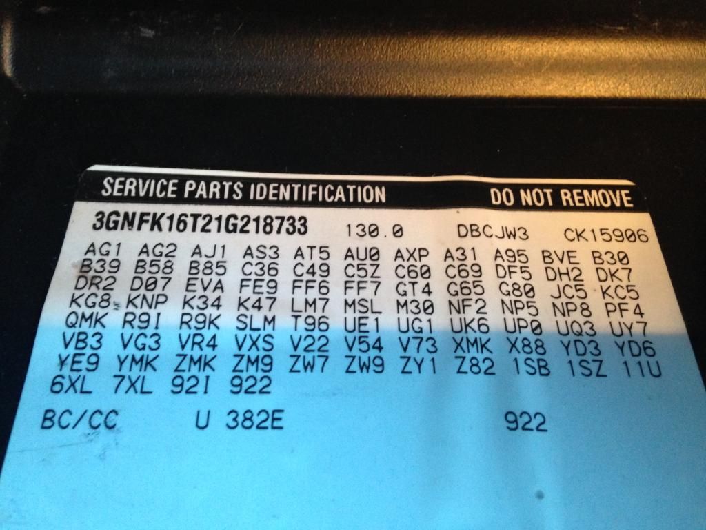

  • With the 6.0L engine in a 2500 truck, it's just over 8000# with the 3.73 rear axle, and just over 10,000# with the 4.10 axle. The "just over" part depends on cab size, 2wd, 4wd, and options.
    The rear axle ratio is available on a code sticker (pictured above). GT4 = 3.73 and GT5 = 4.10.
    Your automatic transmission is a 4 speed. It's a 4L80E.

    What we need to really help you is this picture only of your truck...
    This is a 2001 1500 Suburbans RPO code sticker found in the glovebox. And it told me everything I needed to know about this Suburban.
    Go snap a picture of yours, upload it to photobucket, copy the direct link for the picture, then post a reply here.... Make sure you click the mountain and sun icon above the reply post and put the direct link in with a width of 640.
    This will help us accurately answer your question.
