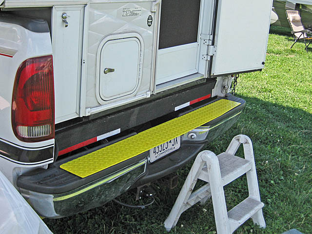

Two truck modifications. I added the reflector strips years ago, they actually show under the tailgate when it is on and gives more visibility from the back.
Our previous camper was short enough we could leave the tailgate on which was nice for coming and going form the camper. The SC sticks out to far so I added the yellow diamond plate on top of the bumper to fill in the gap at the license plate. My idea and friend made it work and constructed most of it. It attaches with two bolts in the center back of the bumper. There is a piece of angle iron welded to the center section and with two well placed holes it allows the bolts to clamp the plate to the bumper.
