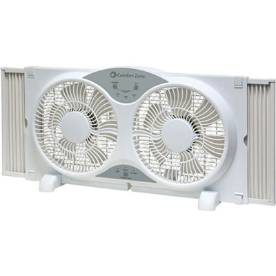

Replace the return air grill for the furnace with a twindow fan. That may pressurize the duct work and keep just a bit of warm air moving. I've not had a freeze up since I did this, and I've rv'ed at -37 c (-34 f).
