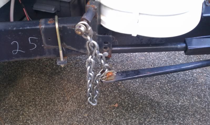

Hensley owners, thought you might appreciate this…. Camping in Hoosier National Forest this weekend. Great time until it was time to go…..
For the past several trips, the curb side screw jack on the HA has been getting harder and harder to turn….been meaning to bench it and see what the issue is. So all packed and hitching up this afternoon, cranking up the screw jack and *BANG* the threaded rod inside strips out and the spring bar jumps down about 2”. Tried to screw and unscrew, no matter what I did the spring bar lost more tension and the screw jack extended. Now completely stripped and won’t tighten….top nut just spins.

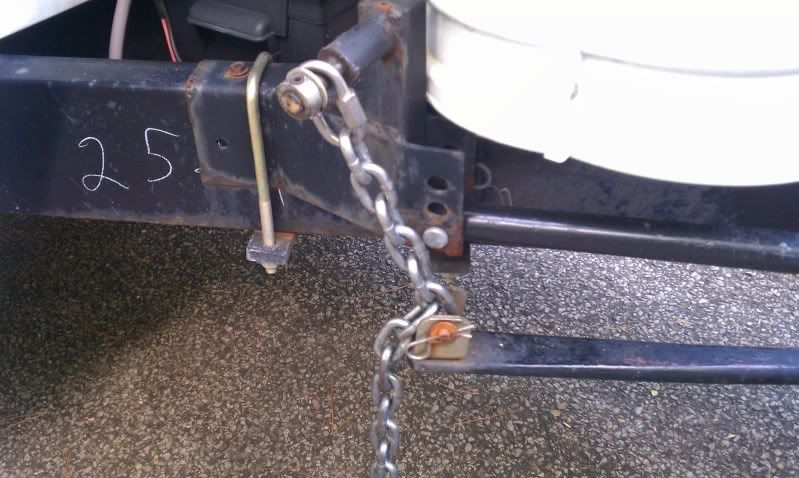

So how to get home on a Sunday afternoon? The screw jack was useless, so I removed it. I remembered last week cleaning out the storage compartment in the back of the Burb and I saw a length of chain…was going to put it back in the garage but figured I would leave it in the truck. The spring link that I had with the chin wouldn’t hold any weight, but I remembered I had a threaded link in my onboard HA parts kit. I got the bottle jack that I use for changing tires out of the TT and put it under the spring bar. I jacked up the spring bar to where it needed to go and attached the chain using the pin from the screw jack. Drove home without incident, truck handled great.
I couldn’t cut the chain so I used the spring link to keep it up out of the way:
So I need to put in a parts call to Hensley tomorrow…I thought I was going to be really screwed but the fix was relatively easy. You can bet that chain is staying in the TT from now on!!!
