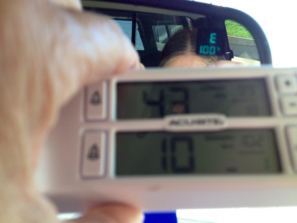

  • The 43 and 10 (kinda hard to see-we were in St Louis traffic) was with an outside temp of 100 shown in the mirror
  • They replaced the switch on the back that turns on the outside fans when the refer gets too hot. Well, the fans are obviously not running. I agree with 43 and 10 but with it set at the coldest (5) the freezer could get down to -10.
