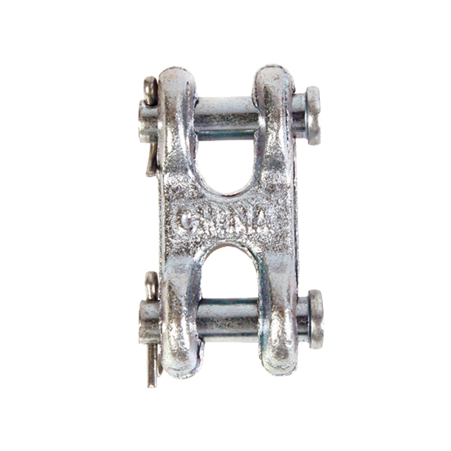

    If lengthening a safety chain, I would replace the entire chain. If shortening a safety chain, I would use a double clevis link. If the link fails, the original length safety chain will still hold. I would never use this to lengthen a safety chain because if this fails, you have no safety chain. (I have a utility trailer that I pull with 2 different vehicles. The safety chains are perfect for the truck, but too long for the minivan. I use these links when using the minivan.)
