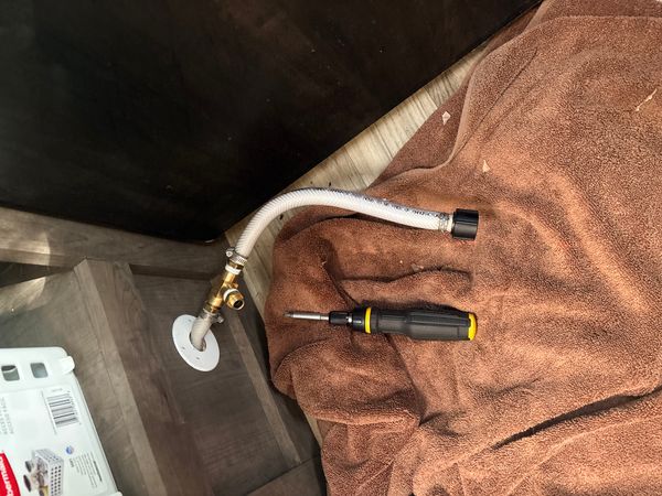

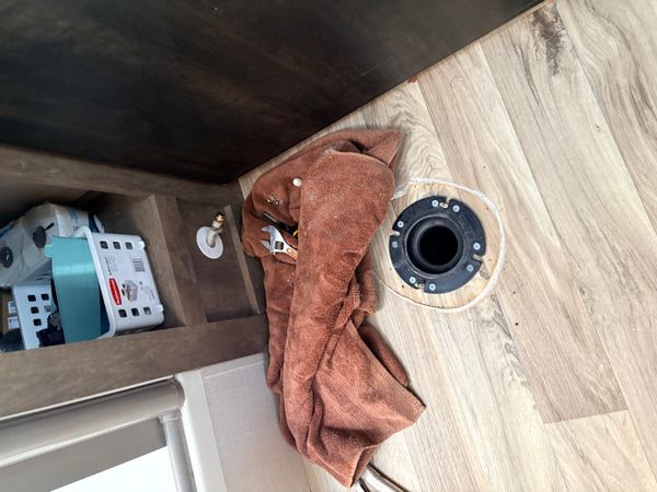

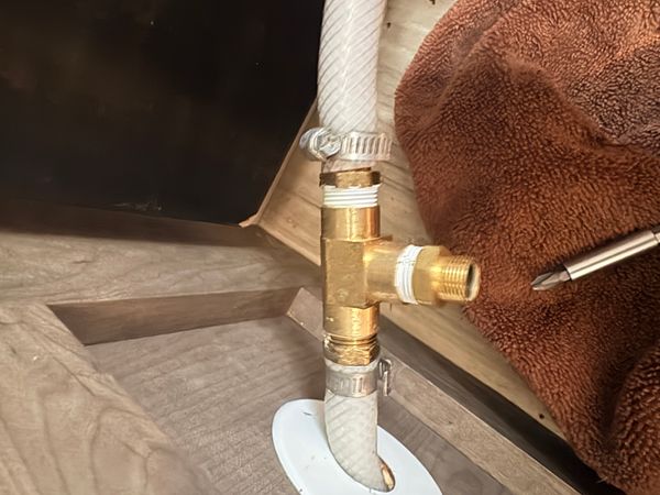

I have a 2019 kz connect travel trailer, the previous owners put a bidet on the toilet. I am taking it out and putting a natures head composting toilet in, what can I do either water line going to bidet and what’s best to cover hole to black tank?
1 Reply
  • Take the tee off the water line and put a valve on instead. Then just turn the valve to the “off” position.
    For the black tank, get the proper size “test plug”, stick it in the end of the pipe and screw it down tight.
