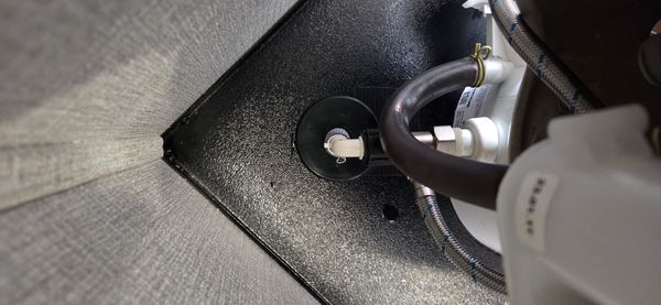

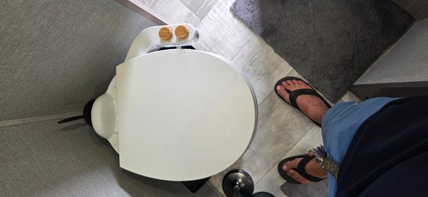

      So on the Momentum 395MS Thetford toilet the install went "OK" We installed left hand installation.   Easy peazy.  Follow the instructions and all works as expected.  I haven't sat on it a washed my bum yet to see functionality.   I'll just talk about the installation.  There isn't enough play in the inlet line to attach the T adapter.  You will need to drill a hole(or 2) about 2.5-3 inches back from the inlet valve. That means the toilet has to come out(2 screws easy).  In the momentum 395ms what ever Bidet you install you'll have to remove because of space restrictions.  We went under and opened the bottom to release some more hose and to help keep the hose out of the way as we drilled 2,  1 inch holes.  So far we are happy so I am gonna call this solved.
