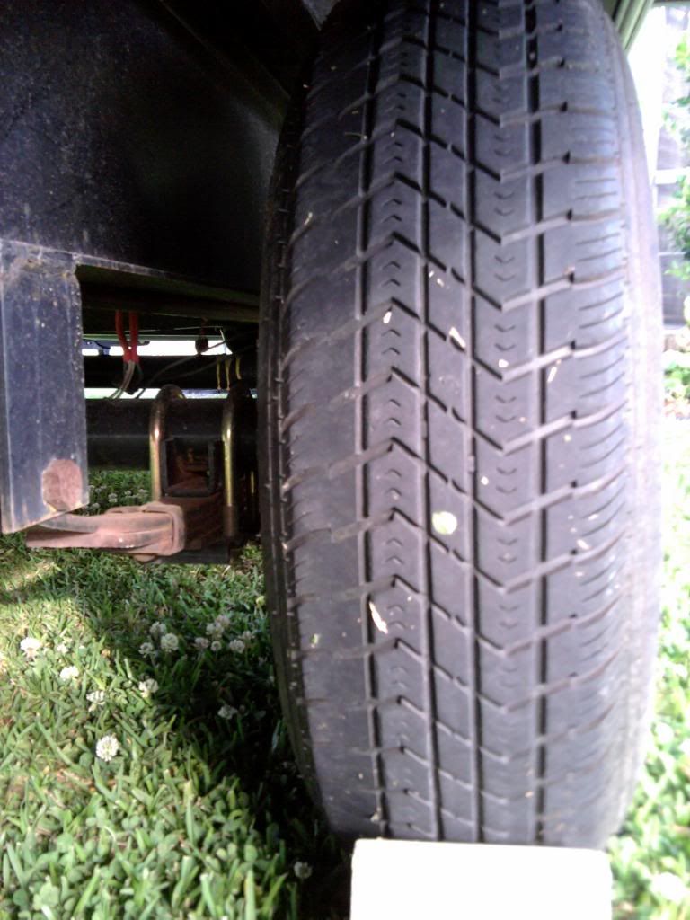

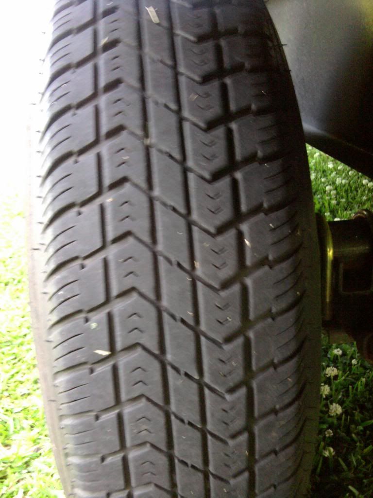

Pull my TT out of storage today to prep for our vacation in three weeks. It has been a busy spring with family get together's so we haven't been able to take it out since March.
Anyhow, when I was hitching up I noticed the the tires on one side appeared to be chopping and extremely worn on the inside.
I have never had any problems with tires or axle's before so I am at a loss on where to start to diagonise the cause of the problem. I have lippert axle's and the cheap factory tires. I have searched the forums and have found similar problems, but none quite like mine.
From what I have read, if it was an alignment issue, wouldn't it be on either the from, back or both? It appears to me to be a camber issue, but where do I take it to have it checked? Do you take it to the same shop that you would you TV? Tires are chopped on the inside, but not completely worn down, do these need to be replaced now as they only have 3000miles on them, or would they be ok for a 1000 mile trip? If I do what would be the best brand to put on?

  • Were you hitched up in photo #1 and not in photo #2 ? That angel of the TV could possibly cause the camber difference especially on concrete or asphalt. Both driver side tires look the same, or just one axle?
  • As it turns out the bearings on this side were loose causing at least some of the problem.
    This is the "before"
    This is the same tires after I repacked the bearings. Considerable different. Note the TT was empty in both photo's Did this fix the problem, I guess only time will tell.
    As a side note, I found that one of the brake adjuster's was not seated and I don't think those brakes ever worked as the drum come off with no effort at all.

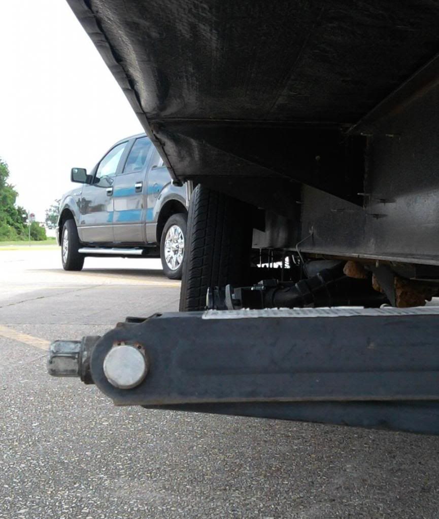

  • This is a picture of the drivers side tire looking aft.

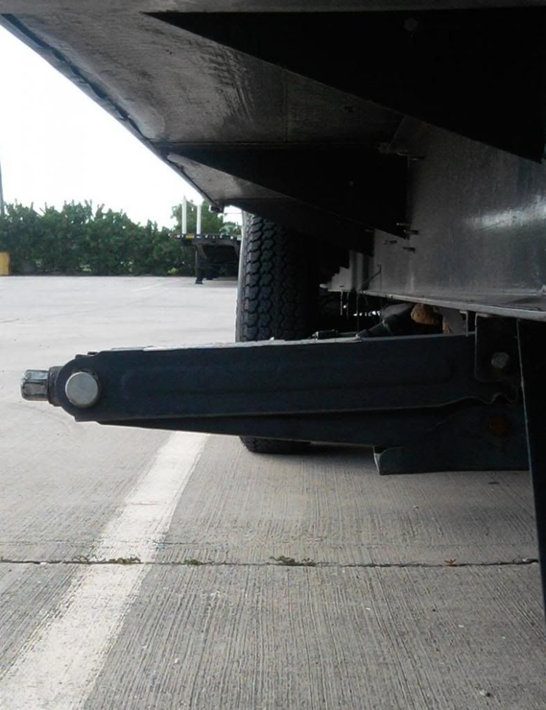

    This is the passenger side.

  • It is ALSO possible that the axles have been overloaded (get individual wheel weights) or that bearings are worn allowing the wheel to fail to maintain it's proper camber.
  • From the way you describe the condition of your tires, it sounds like you have two bent axles. All it takes is one good hard bump to bend them. If they are Lippert axles then in all likelihood they are bent.
    Tubular type axles have a slight bow in them that should be continuous across the whole length of the tube. As the weight is added to the axle tube, it will tend to straighten out to the point were the wheels a basically perpendicular to the road surface. As quick check, park your trailer on a level surface, go to the back of it and have a look at the wheels. The axle tube should be relatively straight and the wheels should look parallel. Also, look at the axles between the springs and the wheels. Each side should be the mirror image of the other. If there is any difference then it's likely that the axles are bent and replacement is the most likely option.
    It would be in your best interests to go to a good shop that deals with trailer repairs. They can tell you what the condition of the axles.
    As for the tires, replace them now! Any kind of damage on the tire like what you described is not good. When you do replace them, go one load range up for added safety.
  • You take it to a heavy duty truck/trailer repair shop. Axles need to be bent or replaced for alignment.
