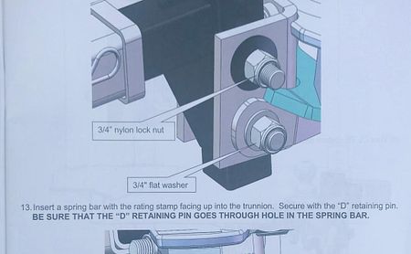

BenK wrote:
A 3/4" bolt will have a hex head with 1.125" across the flats
Therefore, needs a 1 1/8" socket
I think you're right, but they left that out of the list of tools needed. Looks like I need to go check every fastener and make sure exactly what I need and not trust the manual that came with it. That will definitely be a comment in my review of this thing later!
