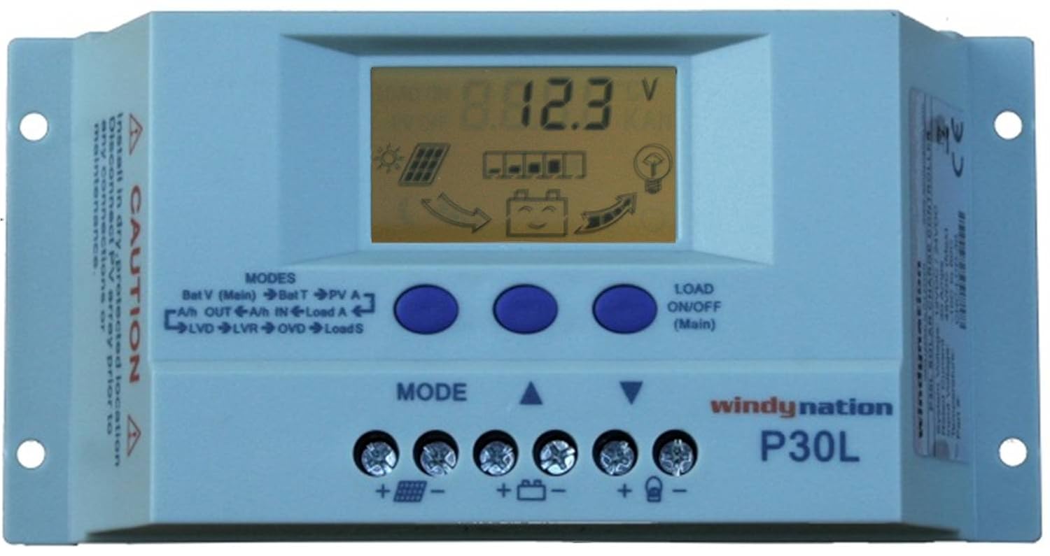

i'm looking at this controller
windy nation 30amp user adjustable
That unit is a solar30 controller it only has one setting. You would need to set it to your bulk then when when you wanted to float change the setting. Kinda a pain realy.
