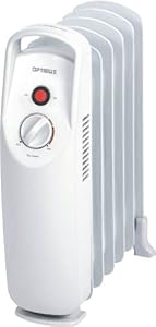

  • Hi,
    It is possible to heat an RV electrically. Replace the return air grill on the furnace with a window fan. Add a mechanical thermostat so the fan will cycle when the cavity gets cold. Use a couple of 500 to 800 watt heaters. I prefer oil filled ones myself as they are unlikely to be a fire hazard.
