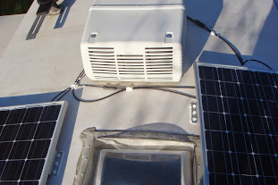

Two 195W panels from "Sunny Power", 32'x60", Voc=44V
Connected in parallel with 2 MC4 Y connectors.
Mounted with double Al 6" angle, 3 SS screws, 3M5200 sealant/adhesive.

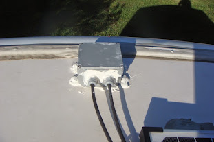

Panels at rear of trailer, 10ga cables run on roof to the front. Found a water-tight exterior electrical box to cover the hole through the roof to the interior cupboard. Drilled a hole in the bottom and two in one side for the wires. Screwed and glued (3M5200) in place. The two wire pass-thrus have rubber o-rings, maybe for cable TV? Fit the wires perfectly.
Run wires inside to bottom of front, side clothes closet just over the trailer's pass-thru. "Baby" breaker box with 15A Solar and 30A Battery breakers (Midnite Solar). Rogue 3048 MPPT. 6ga down to trailer pass-thru where it joins up with a PD9260 charger with convenient double bus. Then down and out to batteries on the trailer tongue.
